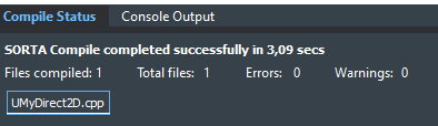

Often you will see unfinished statuses in "Compile status" after compilation. Console outputs are ok.
(5.66 KiB) Not downloaded yet
Similarly, "Compile Message" - often does not refresh the content. Only activating the window by clicking solves the problem and displays the messages.

The correction included in the patch is working. Thank you.
Unfortunately. The correction looked good, but when a compile error occurs, the "Compile Message" window still does not refresh itself :? . It has to be clicked on.
