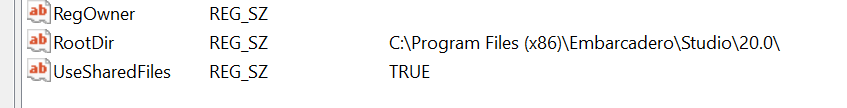

kevin.moloney
Posts: 7
Joined: Tue Mar 15, 2022 8:43 am
Re: The "DWARFVersion" parameter is not supported
Post by kevin.moloney »
Screenshot attached
(7.68 KiB) Not downloaded yet
Posts: 2205
Interesting - and weird. 5.3 added special logic to solve this issue with the assemblies not being loaded correctly. Is there any chance you can use jtmake instead of calling MSBuild yourself?
