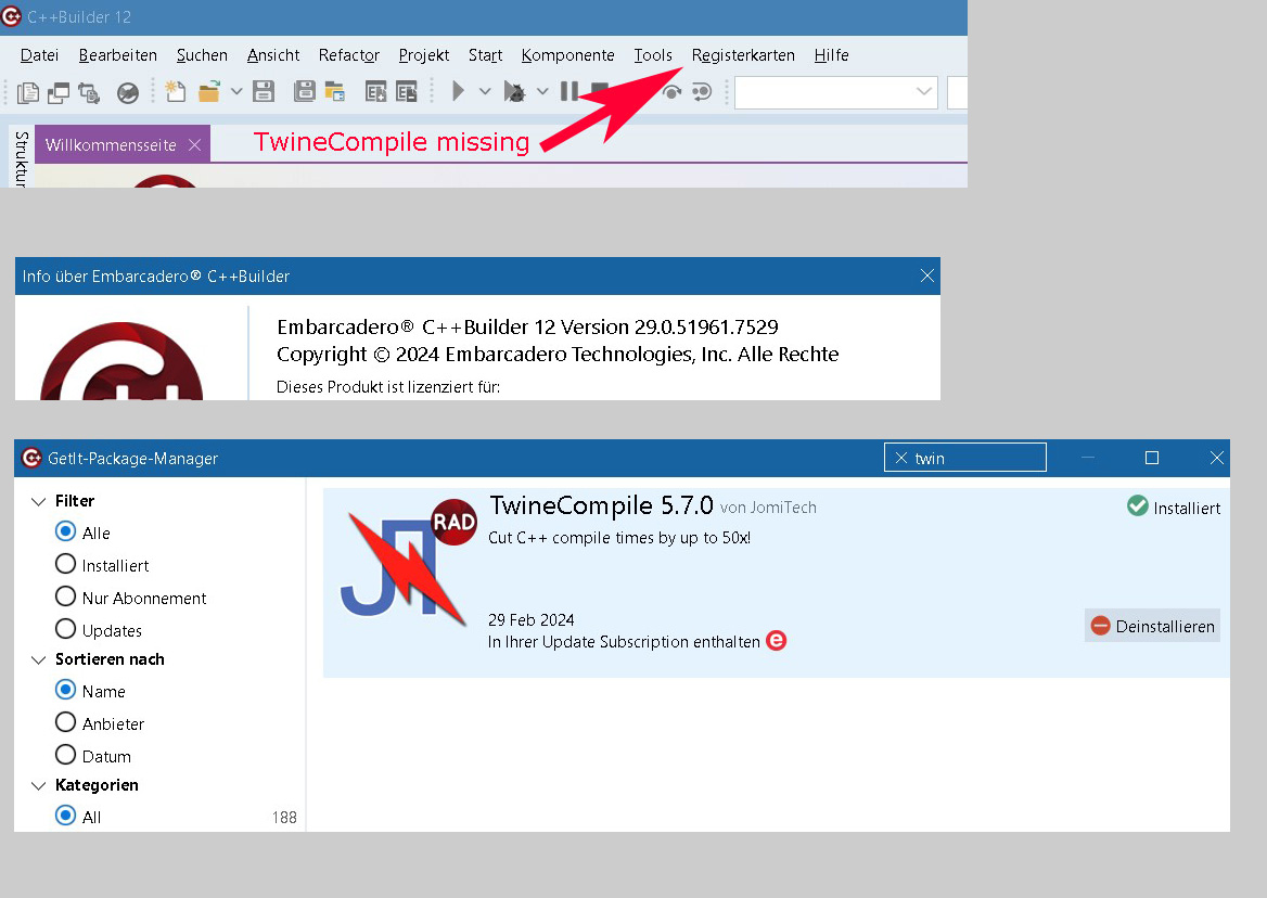

the newest TwineCompile 5.7.0 from GetIt does not show up in C++ Builder 12.1 (29.0.51961.7529.)
C++ Builder has newest Patch R121.patch1-20240417-2.zip.

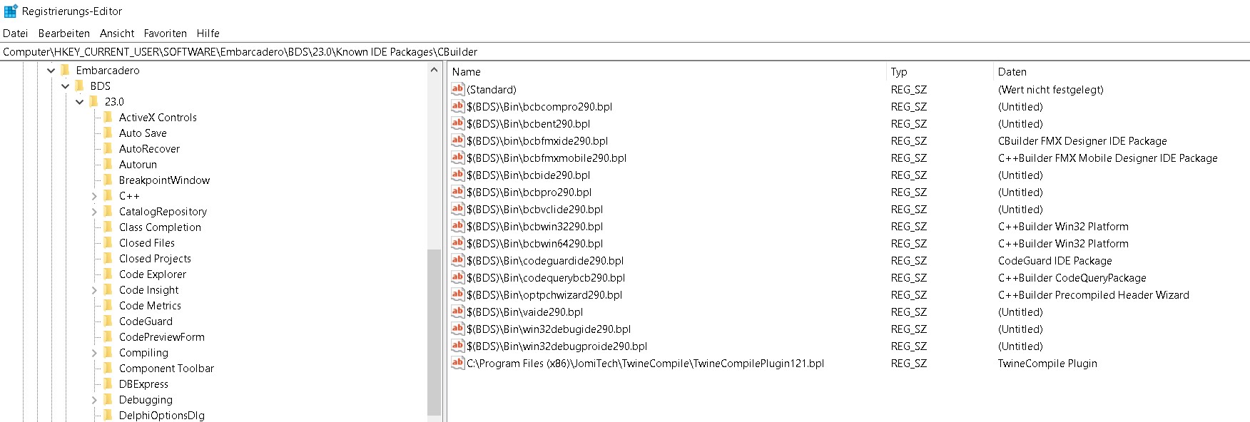

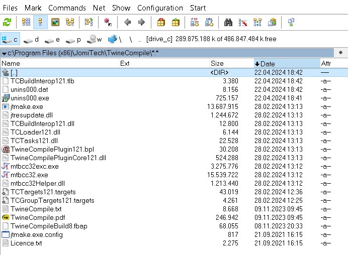

I checked the registry key in HKEY_CURRENT_USER as described in pdf in section "Manual Plugin Registration", the registry key is there, please see screenshots, all information about registry, files in Plugin directory, installed version is in the screenshots.

In the registry, do you have anything under the Disabled IDE Packages key?

Indeed, I had in Disabled IDE Packages an entry for TwineCompilePlugin121.bpl.
Very strange, I have no idea how this happend, do you know?
I removed this entry and now TwineCompile 5.7.0 is working again - Thank you.
Posts: 2203
Re: TwineCompile Plugin Registration fails for C++ Builder 12.1
It sounds like the plugin failed to load once, which causes the IDE to write that entry there. And yes, just remove it, it will allow it to load again.
