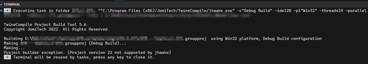

I cannot use jtmake.exe with C++ builder 12. I get the following error:
(25.66 KiB) Not downloaded yet

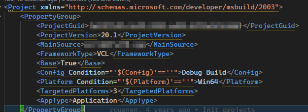

I have upgraded the project files to 20.1 (by opening them in Embarcadero 12 and saving the project file). TwineCompile works perfectly in the IDE. I don't know if I am doing something wrong or something is wrong in jtmake.exe. I do still have C++ Builder 11.3 installed on my computer.

Posts: 2212
Re: Builder 12
Apologies for that issue with jtmake. Please download the following file and extract into the TwineCompile Program Files directory to resolve it.

Richard_008
Posts: 45
Joined: Mon Sep 21, 2020 11:53 am
Re: Builder 12
Post by Richard_008 »
Thanks! Now it works!
