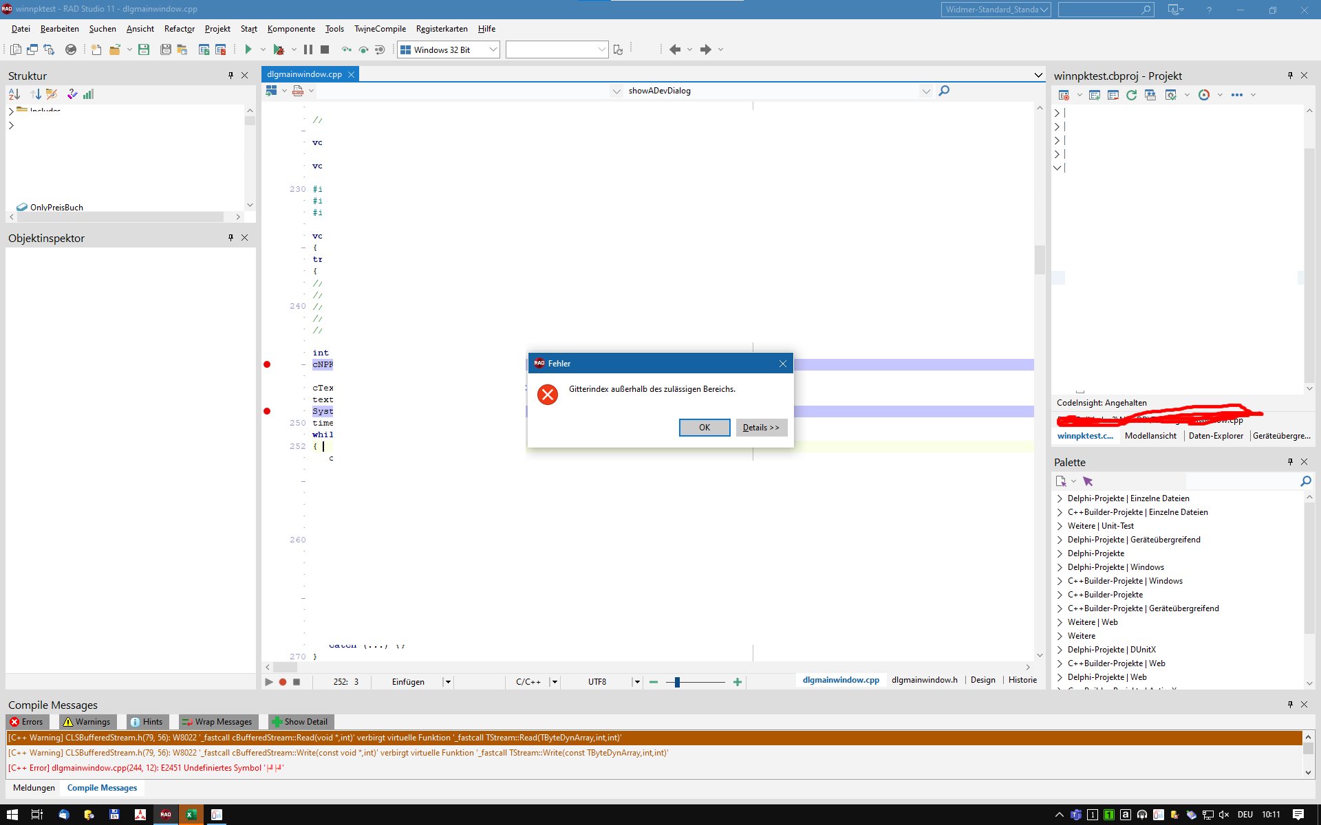

omtom
Posts: 5
Joined: Tue Mar 02, 2021 10:12 am
Re: Gridindex out of range
Post by omtom »
No, it doesn't help.
Maybe it depends on how the tools windows are docked.
Attached is a screenshot of my IDE.
(182.29 KiB) Not downloaded yet
Posts: 2212
Can you provide the exception trace for the error you're getting?

Posts: 2212
I think I figured the issue out. Was very hard to reproduce as it was a timing issue with the message synchronization. Please download that file again, extract into the TwineCompile Program Files directory and see if it resolves the issue:

omtom
Posts: 5
Post by omtom »
After a first quick test it seems to work correctly now.
