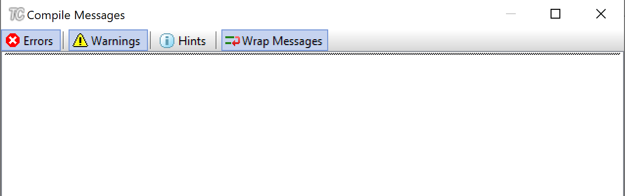

Looks like the list controls don't work properly:
(24.02 KiB) Not downloaded yet
Same thing happens with the compile window: it is just white space where there used to be a list with files currently being compiled.
Update: After a while, the list in the messages window displays something, but it doesn't show errors for some reason.
