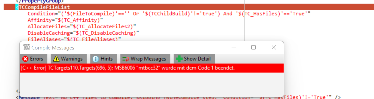

Same Problem here.
Here's a Picture of the Problem:
(90.21 KiB) Not downloaded yet
Is there an eta when a new Version for the 11.1 Release is planned?

TwineCompile 5.4 with support for RAD Studio 11.1 has just been released. Please go to GetIt and download this new version.
