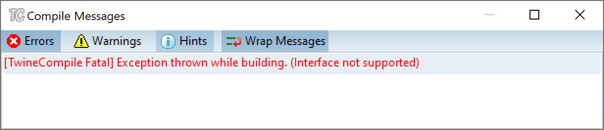

I just upgraded to C++ Builder 10.4.2, installed TwineCompile 5.2.2, and TwineCompile fails at any compilation attempt with this error:
Code: Select all
[TwineCompile Fatal] Exception thrown while building. (Interface not supported)

Yes, this is correct. Due to binary incompatibilities in the new 10.4.2 release, TwineCompile 5.2.2 does not work with it. You need to download the latest 5.2.3 release via the GetIt package manager in the IDE.
