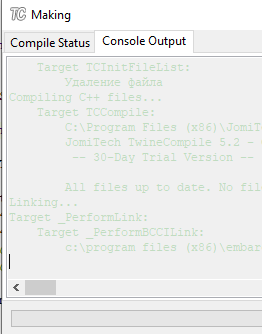

5.2.2.296 and Tokyo 10.2.3 standard(light) theme
Same problem:
(6.45 KiB) Not downloaded yet

Re: [C++ Builder 10.3.3] Color issues
Yes, this is a known issue with 10.2.3 - for some reason the IDE theme services aren't providing the correct color to the console window.
