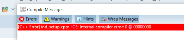

When TwineCompile builders my project I get an error in one file that says Internal Compiler Error 0 @ 00000000. There should be an attached picture. This does not give me much information to work with for fixing this. Do you have any suggestions? Any setting changes I might try? When I use the normal C++Builder compiler it works OK.

1) I turned off the caching in the TW options and the result was the same with the Internal Compiler Error. I build for release and debug. There should be a picture below showing the results.

3) The file that causes the error in TwineCompile is named ind_Setup.cpp and I have included a screen shot of the MSBuild compile information for this file. These pictures are below.
