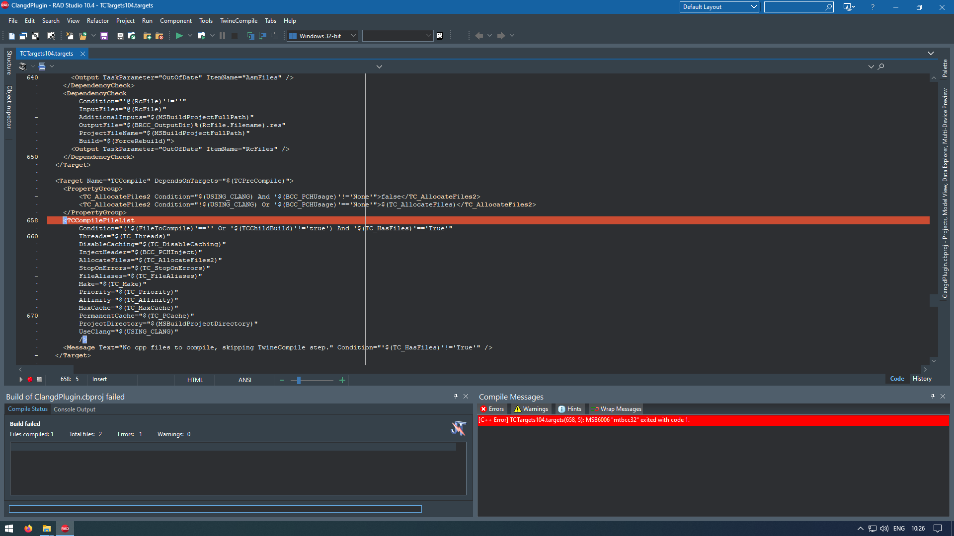

when compiling with TwineCompile 5.2 i often get this error "[C++ Error] TCTargets104.targets(658, 5): MSB6006 "mtbcc32" exited with code 1." when doing "Build". If i try to "Make" the project after the error it compiles fine. I am using bcc32c and bcc64 compilers, i haven't tested this on the classic bcc32.
Another problem that occurred to me a couple of time is a linker error "unresolved vtable for TForm2" when I do "Make". If I then do a clean and build it compiles just fine. I'm not sure if this is related to TwineCompile. (I have proper configuration of output directories so i don't have a clue why this is happening).

Re: [C++ Error] TCTargets104.targets(658, 5): MSB6006 "mtbcc32" exited with code 1.
Can you provide the output from the Console Output tab in the compile window when you get that mtbcc32 error?

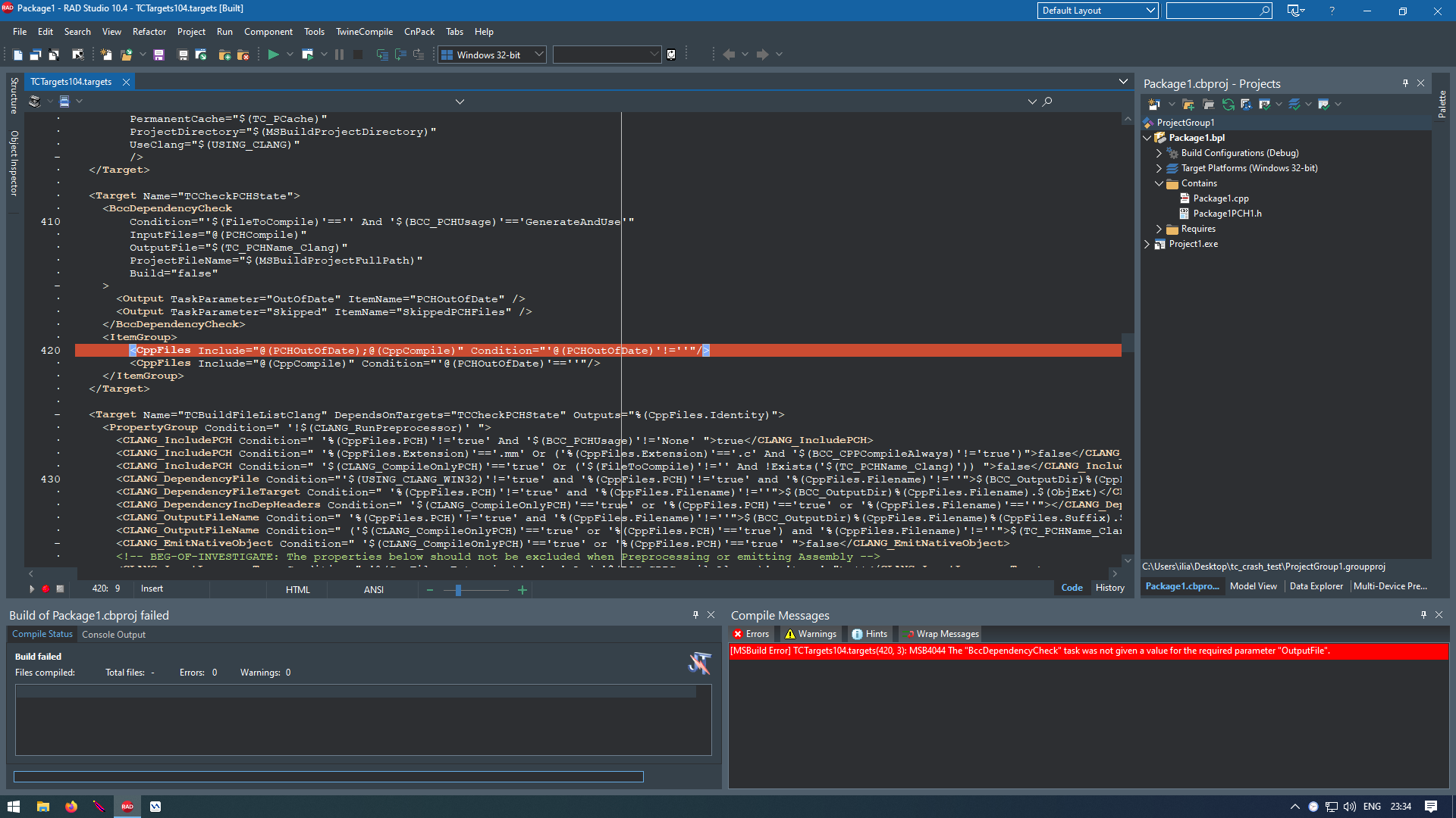

Hi,
sorry for the late response, I just tested the update but it outputs the following error: Here is the output:
This is tested on the same demo project.
Best regards!

C:\Program Files (x86)\JomiTech\TwineCompile\TCTargets104.targets(420,3): error MSB4044: The "BccDependencyCheck" task was not given a value for the required parameter "OutputFile".
My apologies, wrong file was attached. Please try this one.
This one works as expected, thank you!
