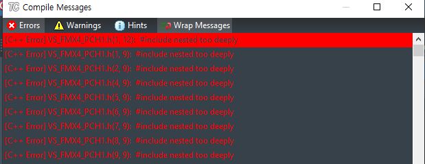

When I build the project with the PreCompile option enabled, as shown in the attached image, an error occurs. There was no issue with previous projects, but this error has occurred in a new project. The main cause seems to be that the compiler does not compile the PCH.h file first.
If there are any additional files you need, please let me know. Thank you.
TwineCompile Error Img
(24.02 KiB) Not downloaded yet

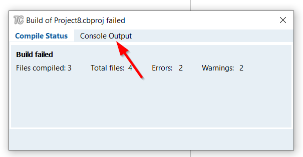

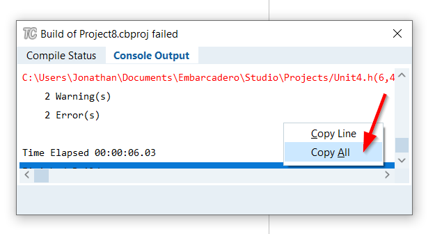

Thanks for the files. I need the Console Output of the build, not the list of error messages. Run a build that reproduces the error, then in the Compile Window, click the Console Output tab, right-click in the console output text, and click Copy All. Then save to a text file and zip/attach here.
See these two screenshots:
(11.94 KiB) Not downloaded yet
(17.39 KiB) Not downloaded yet

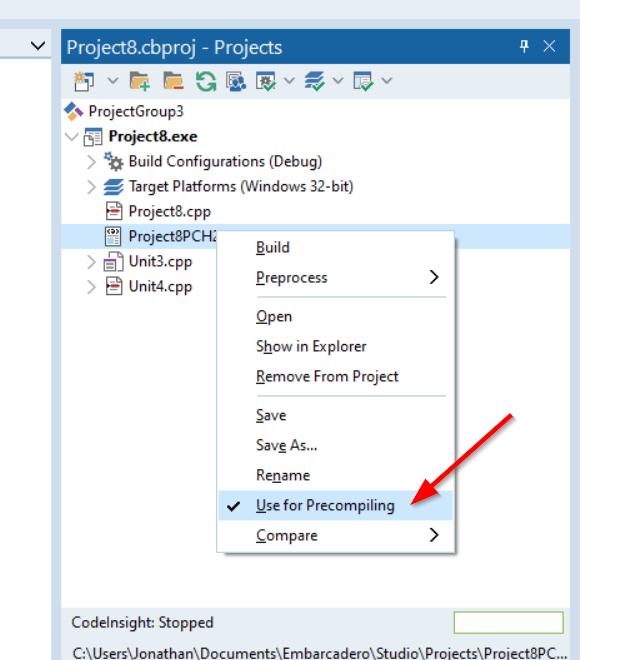

Based on these logs, the PCH file has not been set up as a pre-compiled header file, so it's not being built. In the Projects view, right-click the PCH header file, and select the "Use for Precompiling" option. Then save the project, and run a full build. This should resolve this issue.
(89.43 KiB) Not downloaded yet
