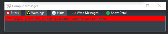

Hi,
I am using Rad Studio C++Builder 11.0 Alexandria Professional with Mobile.
I downloaded TwineCompile 5.5.1 from the Getit package manager.
I am trying to use TwineCompile but I get the error: "[TwineCompile Fatal] Project builder exception. (Interface not supported)".
I tried to fix it but couldn't. In addition, I am using the CLANG compiler in my project.
Could someone from JomiTech please look into this issue?
Thank you.
Best regards,
Roi.
(8.71 KiB) Not downloaded yet

Re: TwineCompile 5.5.1 - interface not supported for C++ Builder 11.0
What updates do you have installed in C++Builder 11? I would recommend installing Update 3, and then installing TwineCompile 5.7 from GetIt.

Hi, thanks for your response.
My RAD Studio 11.0 version is: 28.0.42600.6491
Moreover, I don't see any update in the updates area in the Getit package manager.
Is there another option to make this work?
Thank you.

Posts: 2205
If you can't install the updates, you'll need to downgrade to TwineCompile 5.3 to be able to use it with C++Builder 11.0 (5.5 is for 11.1).
Uninstall TwineCompile, then download 5.3.2 using this link, extract the setup and run it - https://jomitech.com/downloads/TwineCom ... tSetup.zip

Hi,
It works great with this version.
Thank you very much!
Best regards,
Roi.
